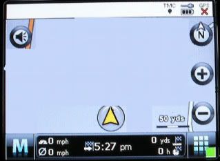

Here are a few very poor screen shots I just did.
Shows POI-Warner running in main nav screen, green box bottom right.
Map removed for obvious reasons.
POI-Warner main menu screen. Click Stop Monitoring to carry on

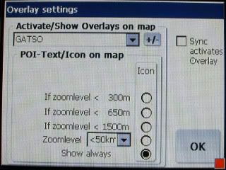

Now the menu you don't seem to have ! Overlay Settings..
Or should I say this is the menu you are missing. Notice the Show always, or you
can select when the Icon will show and at what zoom level
AS I said before, once you have finished all the settings use the menu below and Quit the program. Don't use Start Monitoring. Reboot your nav unit for the alterations to take place.
