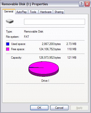

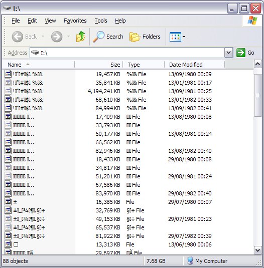

Thankfully I did have a very recent backup of this card, all I did was inserted it into my new Epson CX6600 scanner/printer it scanned in 4 pages, wrote to SD card (done it several times this way already and not had a problem), this time it wrote okay to the card, but when inserting it into the PC the FAT table is totally corrupted.
Take a look at the screenshots below:-
As you can see from the above screenshots, although Windows thinks the SD card is still 128mb in size, the files on the SD card total 7.68 GB!
Practice Safe Backups! This might sound like a cheesy 'Practice Safe Sex' school video, but it will really save you! Now I think it's time to seriously re-think replacing most of my SD cards, as it looks like they're gradually on their way out after having three starting to fail this year, it's starting to make me a little jittery!
